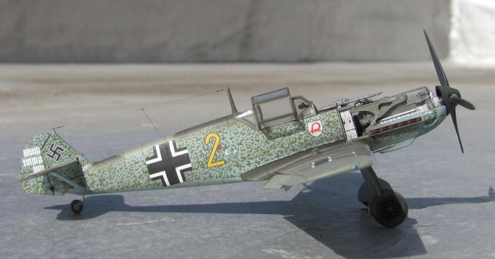

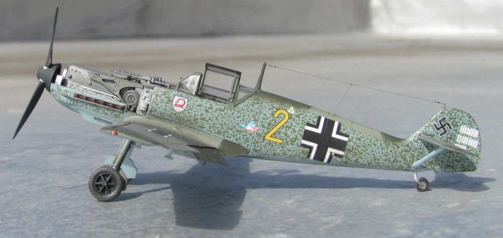

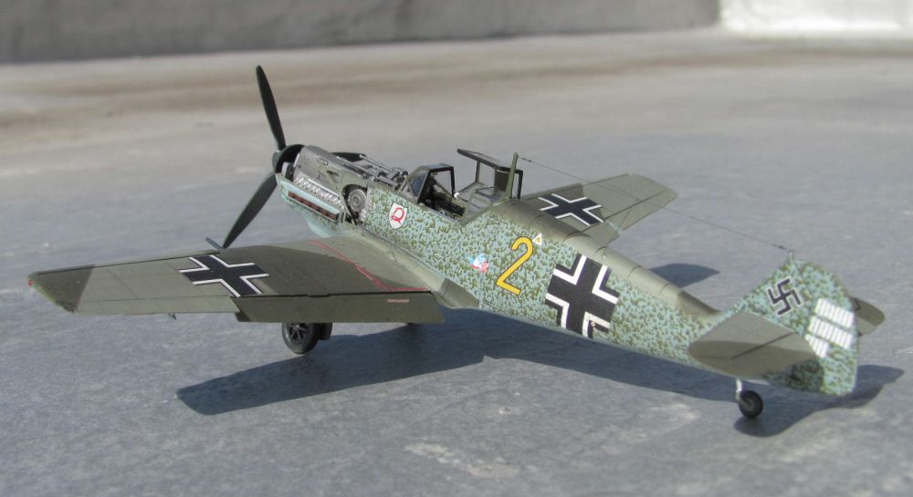

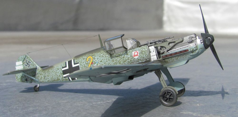

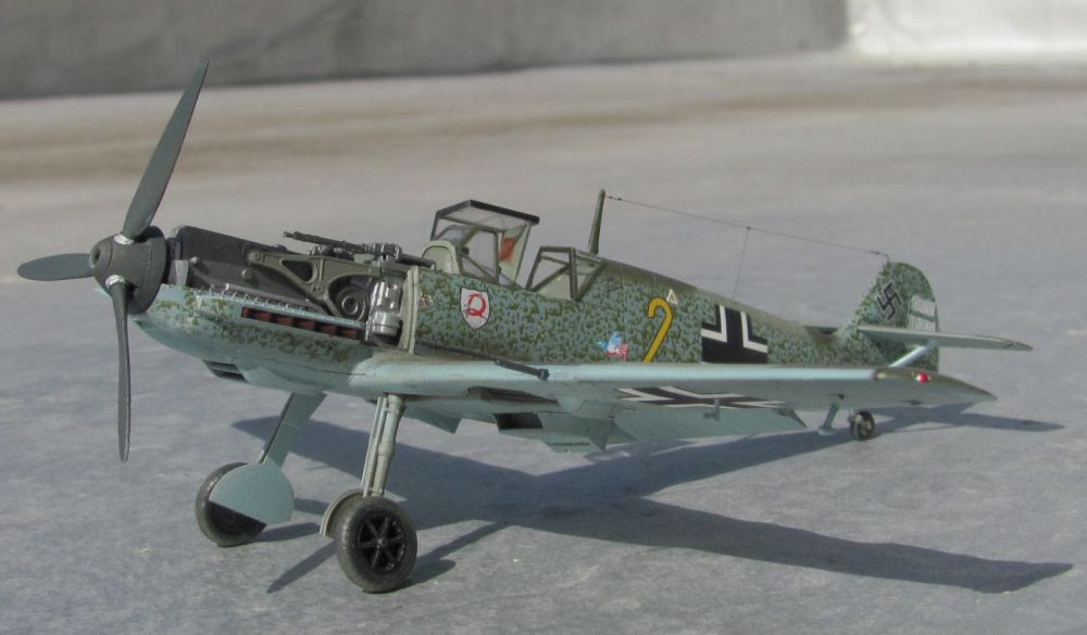

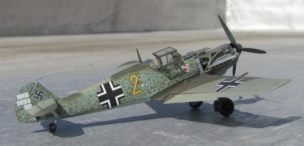

7) 08.06.2021-13:14  -  Libor Malý    Messerschmitt Bf-109E-4, SPECIAL HOBBY 1:72, se lepí
Just a few images of the same model; this time taken by courtesy of Rob in hot California sun:-)
